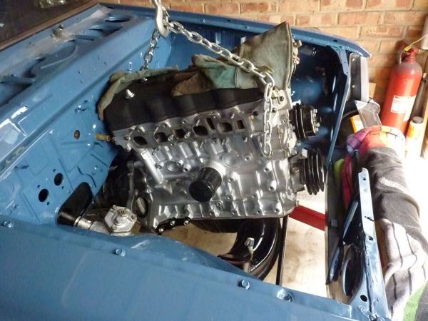

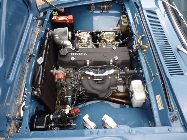

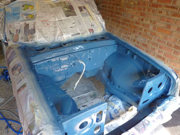

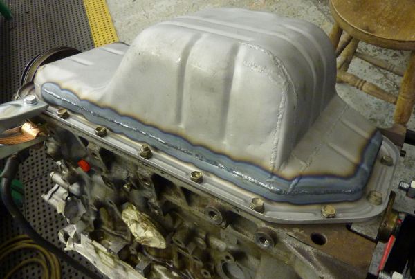

At the end of the 2010 show season I bought a 1985 Toyota Celica for its engine and gearbox. The Celica was used for a month to ensure I was happy with the powerplant and duly stripped for the heart transplant. The engine was one of the last to have a carburettor and as such was an ugly mess of pipes and sensors. I stripped the engine of all external parts and set about offering it into the engine bay. The sump required refabrication to clear the chassis crossmember. I further tidied it up a lot and shod it with two new 40mm DCOE Weber carburettors on new manifolds sourced from The USA. The flywheel lost a kilo in excess weight and balanced with a new clutch. Once I’d stripped the engine bay back to bare metal and repainted in the correct shade of blue, the engine and gearbox were fitted along with a new Celica radiator. As I build cars with restraint, I didn’t want much noise from this setup so I fabricated an airbox for the carburettors’ intake to limit induction noise. I fabricated the exhaust system in 2 ½” stainless steel with two silencers. Since the car was already running disc brakes as standard, I added a remote servo to boost stopping power.

The sump post being welded
fergus_rt40_bay
Repainted engine bay awaits the engine
fergus_rt40_hoist
The 1972cc Toyota 21R enters…
fergus_rt40_21r
The fettled engine in all its glory: 120 bhp. Torque: 130 ft-lb

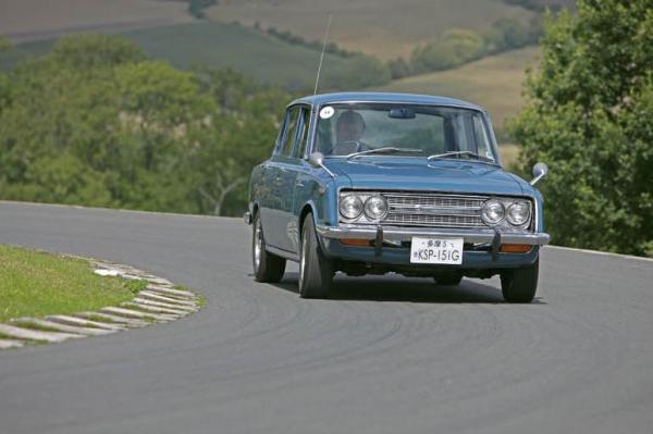

Once back on the road I was really pleased with the results which turned out just how I was hoping. Not too much noise, bags of torque and pleasing driveability. It’s a little rocket but takes little away from the dignified nature of the Corona. In general driving it’s relaxing and docile but giving it some stick away from the lights reveals a very different car. The extra gear helps with motorway cruising too. I’ve yet to run the refreshed car up the drag strip to measure performance but I’m not sure it’s absolutely necessary. Summer saw a long trip down to Cornwall then up to Retro Rides Gathering at Prescott Speed Hill Climb where the car was given several spirited runs up the hill.
fergus_rt40_climb
The Corona at Prescott Speed Hill Climb
